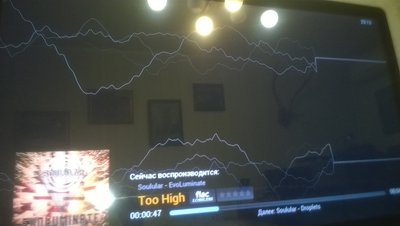

I've installed this version. The blue led is flashing all the time.(flash-flash-pause-flash-flash-pause... rrrrr). Order of the audio devices is different (4.95.3). Video, audio - ok. But there is some strange effect on visualizer(1/3 of visualization is straight line. always). see on foto.
If you need more info, logs, tests etc... I will be happy to help

Hekser Wrote:The blue led is flashing all the time.(flash-flash-pause-flash-flash-pause... rrrrr).
Didn't noticed that one file is missing. To fix wait for new version tomorrow or run this commands in ssh console
mount -o remount,rw /flash
curl -o /flash/imx6q-tbs2910.dtb https://dl.dropboxusercontent.com/u/8224157/public/imx6q-tbs2910.dtb
sync
reboot
vpeter

Postby Hekser » Fri Dec 05, 2014 5:37 am

Done. It is still flashing
P.S. I've updated my 4.95.3 version to this using samba Update folder.

Postby vpeter » Fri Dec 05, 2014 3:40 pm
Hekser Wrote:Done. It is still flashing
Then wait for a day so I can test myself. I was busy at work and didn't do anything when I come home.
